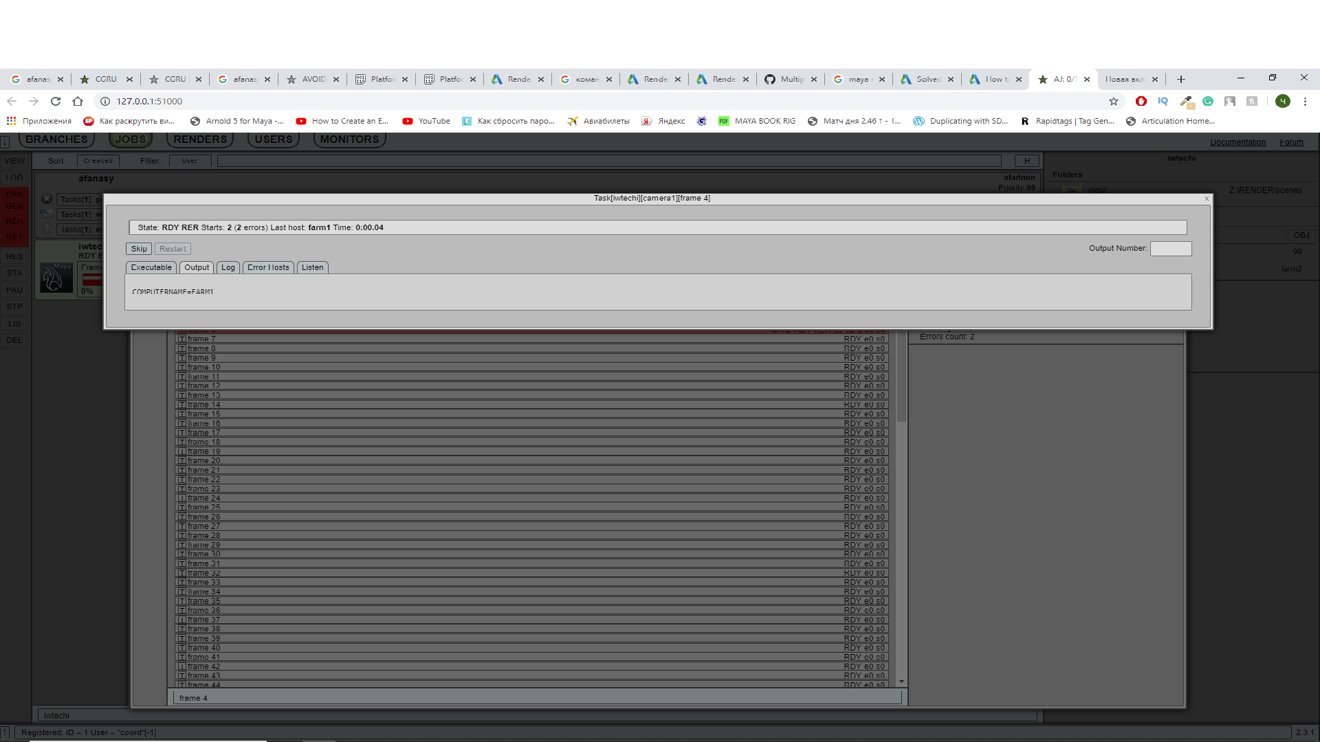

Hello there,
I have a problem, i cannot properly render my scene at all here are the screenshots
Re: Problem here(Maya Redshift)
Posted: Tue Jun 02, 2020 5:31 pm
by timurhai
Try to launch task command within console (cmd.exe).
You can open console (terminal) from cgru keeper, or call setup.cmd in the cgru root folder first.
ps
Try to use an english windows and ascii characters for work. MS Windows always produce coding errors.

Well unfortunately on other PC's i have these problems
Wed 03 Jun 17:00.14: INFO Render registered.
Wed 03 Jun 17:00.15: INFO Started PID=7624 [maya:1000] farm2: iwtechi[camera1][frame 3]
Wed 03 Jun 17:00.18: INFO Finished PID=7624: Exit Code=-1073741819 Status=-1073741819
Wed 03 Jun 17:00.19: INFO Started PID=13180 [maya:1000] farm2: iwtechi[camera1][frame 6]
Wed 03 Jun 17:00.22: INFO Finished PID=13180: Exit Code=-1073741819 Status=-1073741819
Wed 03 Jun 17:00.23: INFO Started PID=1196 [maya:1000] farm2: iwtechi[camera1][frame 6]
Wed 03 Jun 17:00.26: INFO Finished PID=1196: Exit Code=-1073741819 Status=-1073741819
Posted: Wed Jun 03, 2020 11:43 am
by timurhai
On almost any problem you should launch command in the console.
Copy command from AfWatch and paste in cmd.exe.
There is a russian forum: http://forus.cgru.info/
