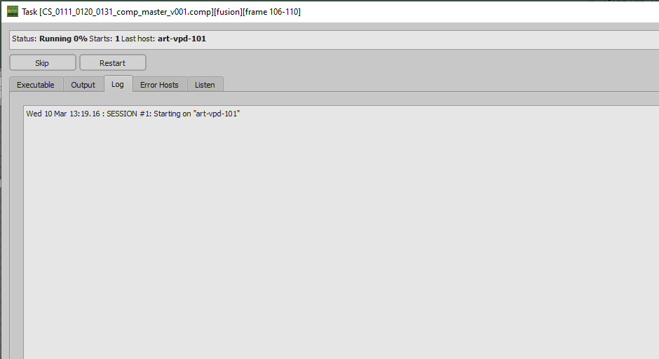

Hi,
Tell me, I have a strange problem with the parser. Errors are not displayed in the log (for example, a missing plugin).

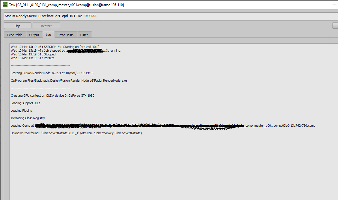

But if I press stop and then start, I get all the information I need. (the restart button does not help)
Tell me where to look for a solution to the problem?

I haven't made any changes to the parser yet.
Sometimes our specialists use plugins for Fusion 16 that are not installed on workers. In this case, rendering in afanasy can continue indefinitely, there are no errors. If you go to the worker (via RDP), then in the logs there is a message about missing plugins. In order to see information from the logs, you have to press Stop in fwatch, and then Start.
(Afanasy 3.1.0)

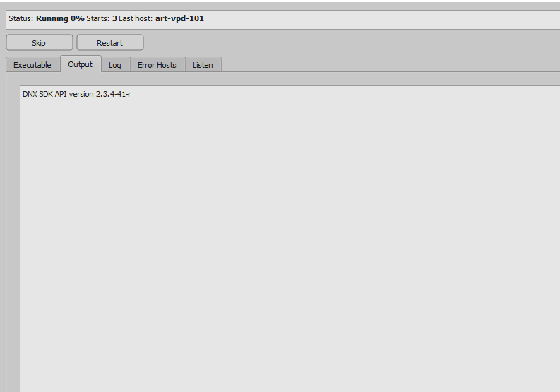

If the plugin is not found, then all I see in Output is:
