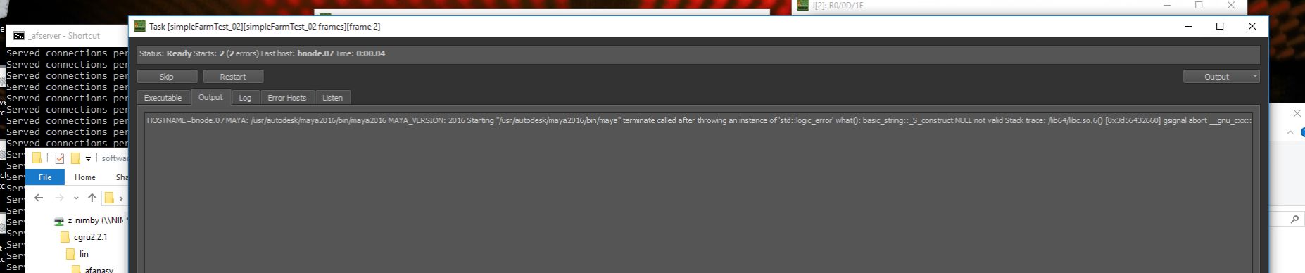

Output window should show output as listing rather than all text in one single line...
See attached for explanation:
Have you seen this Timur?
This is a new install. Our previous (pre 2.2) install would list correctly..

I feel like the problem could be before that?
Could someone put this in one of your output folders and see if it displays correctly in the output window?
