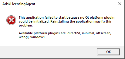

I have submitted a job outside of 3ds max, initally I got a license error for max but now it seems to be working (see screenshot)
Now, I'm left with the problem of the maxscript error when I try to submit within 3ds max, which is predominantly how I would like to submit my jobs. (I have also been unable to get the menu integrations in max, I have tried adding the path to the startup.ms script in customise user paths to no avail - instead I manually ran the afanasy.mcr inside of 3dsmax, and added it as a toolbar button)
afanasy error.png (9.17 KiB) Viewed 37207 times

Update in addition to the above: I am trying to submit to max 2022 and the licencing error I mentioned above with the screenshot is occurring and won't launch max.

You latest screenshot attachment is not a license error, it is a Qt plugins error.
After whan exactly that error dialog is raising?
May be 2022 Max installation got own Qt or PySide too?
Try to remove line
set "QT_QPA_PLATFORM_PLUGIN_PATH=%python%\Lib\site-packages\PySide2\plugins"
from
cgru/setup_python.cmd
file.
