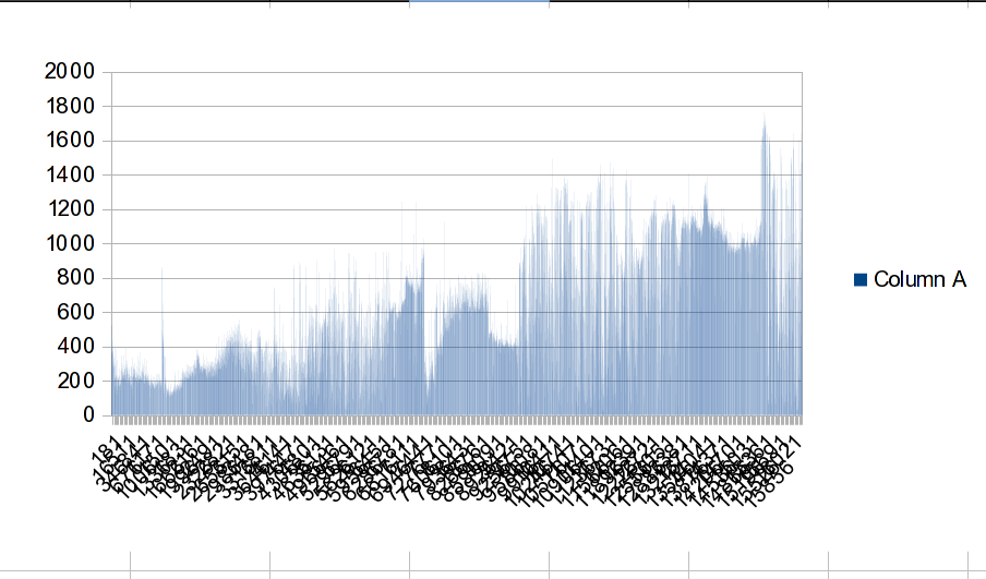

I have visualized the profiling. proc times are getting higher the longer it runs.
and at some point the server just hangs. times are dropping to 6ms and no further connection possible. I have to restart it then.

Re: Question about server profiling
Yes, spelling, grammar mistakes you can push directly to master anytime.
For i now i do not know what to say about profiling.
We should write more complex profiling to detalize "proc" times.
May the next server rewriting stage with 1 thread with no mutexes will solve this problem - but this take much time to implement.

Post by selsner »
Problem solved, I don't exactly know how. I just updated to HEAD and it went away.
