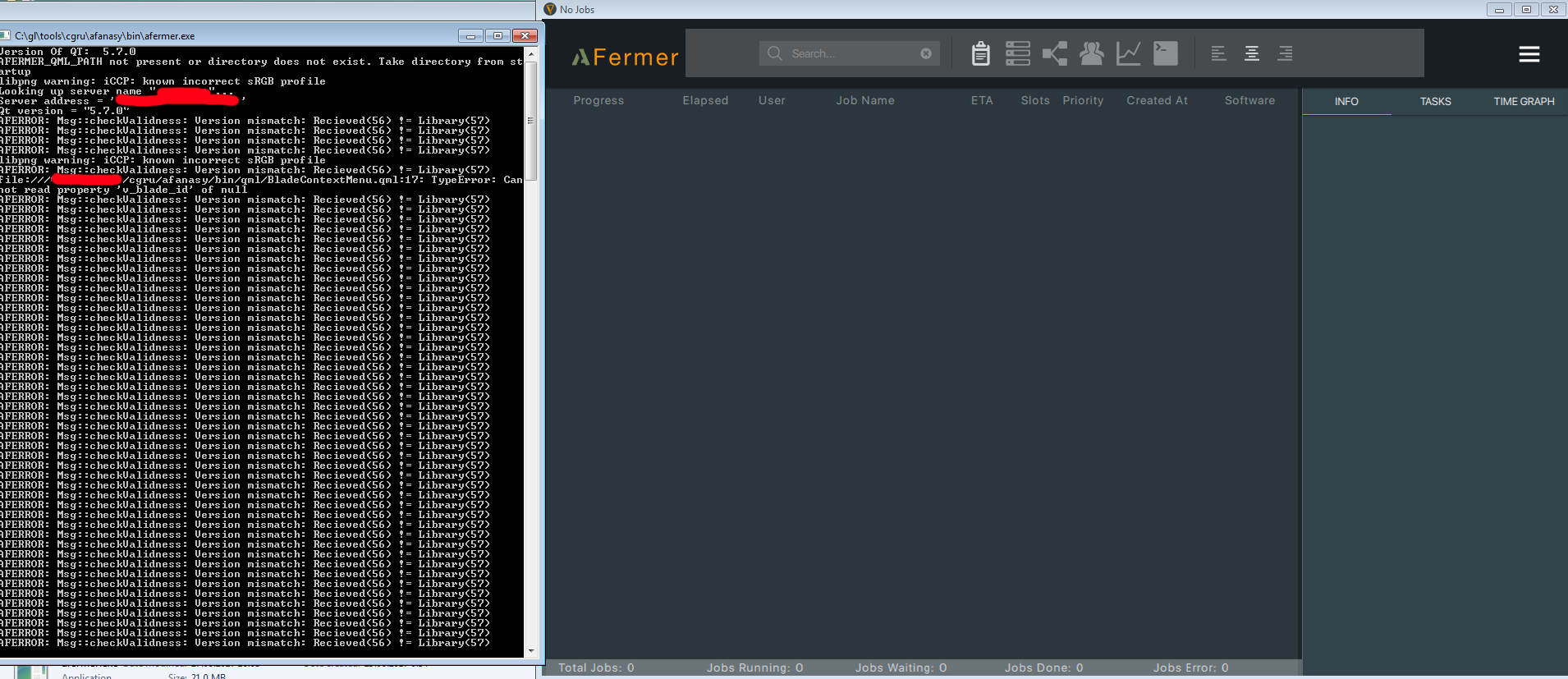

I can't get it work. I try to start it with windows client (afanasy server 2.2.2 on Ubuntu 16) and i constantly get this error:
AFERROR: Msg::checkValidness: Version mismatch: Recieved(56) != Library(57)
And there is no jobs.

Re: Afermer rendermanager
There is 2.3.0 version in GitHub master branch, which is non-compatible with 2.2.2.
Post by zaren »
Hello!
It was compiled for afanasy server 2.3.0. Sorry =)
I'm going to compile against 2.2.2. Shortly it will be presented.

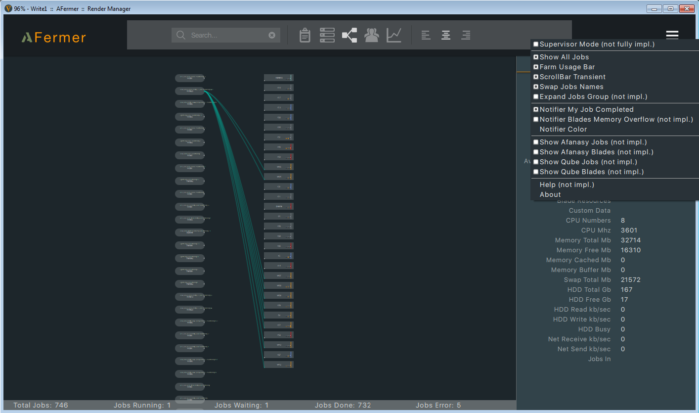

Hello!
Thanks. Some svg icons missing. But work well with python2.7. Looks like its kinda limited now =)
