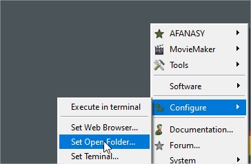

But when i set Open Folder, command is still opening \\Documents
tkx in advance
Re: Task - Browse files/Preview
"Set Open Folder ..." stands for file explorer program customization. Practically it needed on linux only, on windows native explorer almost always is used. So you should not touch this item.
(On linux you can set "nautilus @PATH@" to use nautilus explorer and @PATH@ will be replaced on the folder to open.)

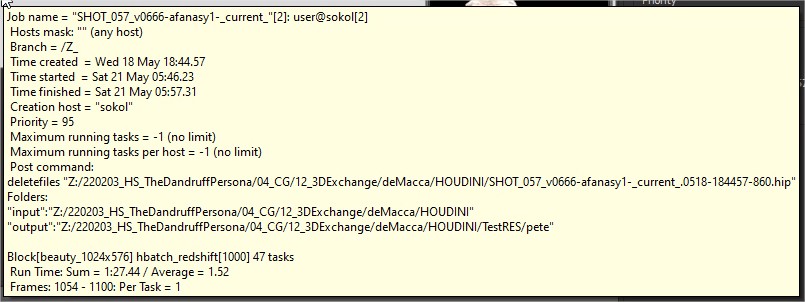

3dlp
Posts: 12
Joined: Thu May 19, 2022 3:12 pm
Post by 3dlp »
You mean this ?
When watch tries to do something, it usually prints some info in info line (status line) at the bottom of the dialog.
- is that folder correct?
You are showing tooltip.
- folder in tooltip correct?
