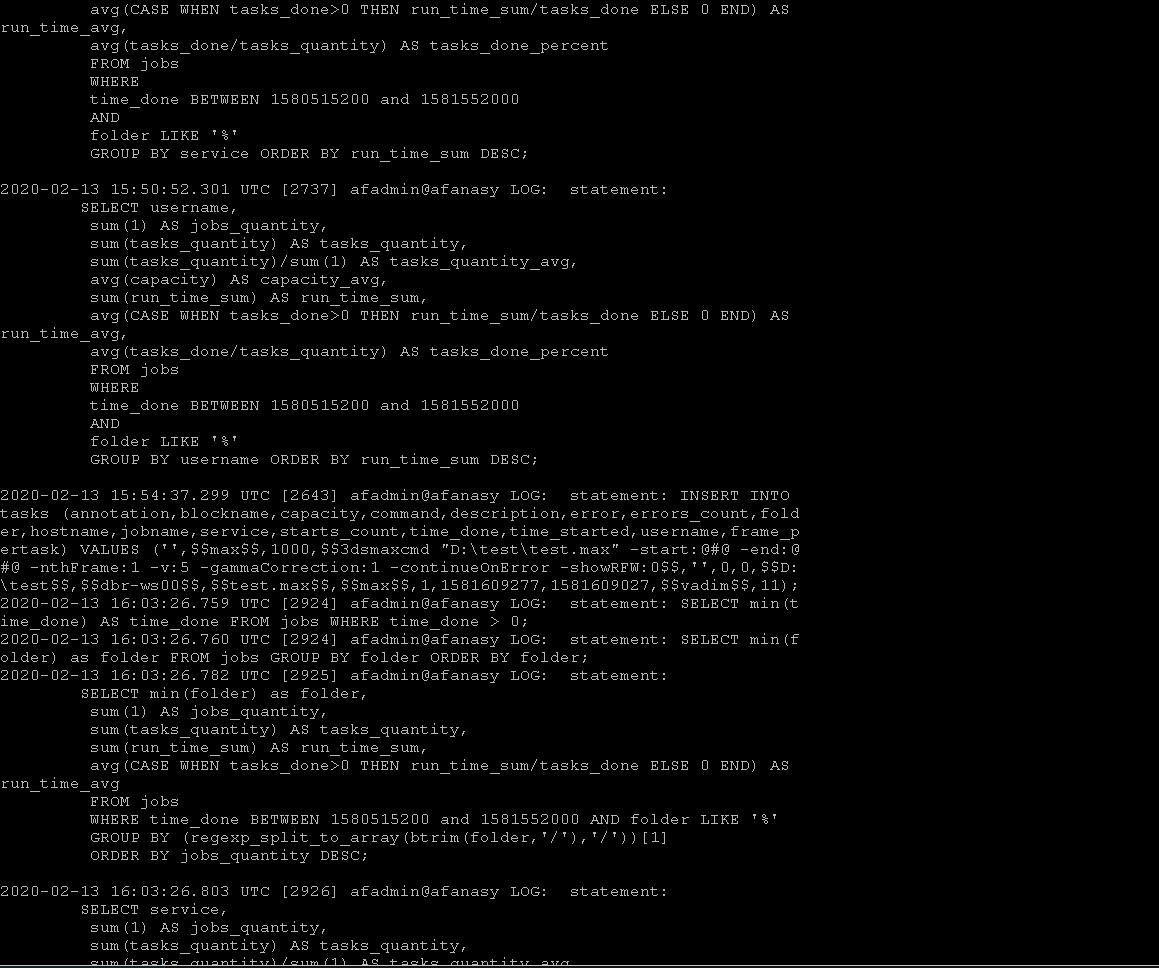

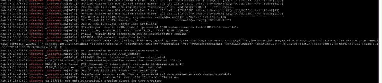

In the table TASKS created record
There are no entries in the JOBS table
Added afadmin database user, super user rights, just in case
Here is a screen of server logs and DB
- photo_2020-02-20_21-24-10.jpg (17.69 KiB) Viewed 28349 times
- photo_2020-02-20_21-23-29.jpg (75.91 KiB) Viewed 28349 times
Re: Afanasy Statistics
It is hard (some times impossible) to read images that you attach. Can you not to do it.
If you want to show some text, please copy and paste it as a text.
And it seems that you should consult some SQL (PostgreSQL) experienced user, i am not.
Or try to google this psql errors.
"FATAL ..." errors are printed by pslq library.
