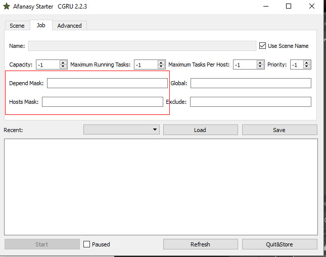

Sorry, I'm not sure how to set up all the example you mention in the last post!! How can I set Host Mask? do I need to rename all the machine on render farm?
- 001.jpg (55.31 KiB) Viewed 30012 times
Re: How to create multiple render pool in cgru?
It is "Hosts Mask" and "Exclude" fields in that dialog. Exclude - what hosts to exclude.
Hi Timur
Thanks for the reply. To confirm the hostmask is the red box I highlight in the picture right?
Thanks
Desmond
Thanks
Desmond
- cgruQ1.jpg (27.36 KiB) Viewed 29992 times
That are render machine hostname and afrender username.

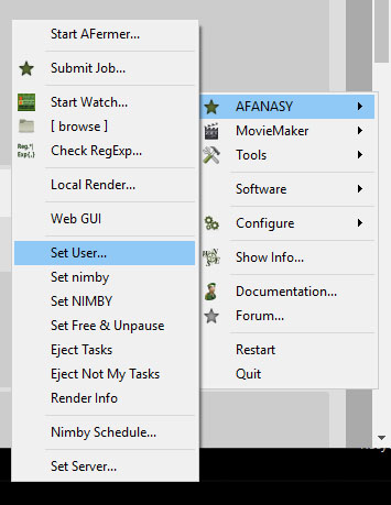

hi Timur
So I have a question. How can I set every each machine have a specific host mask name like you mention?
Set User name to change?
Thanks
Desmond
Thanks
Desmond
- cgruQ2.jpg (56.88 KiB) Viewed 29987 times
"Hosts Mask" is a job property (not render). It means that a job with "sim.*" hosts mask will run tasks only on machines that names match mask, like "sim01", "sim02", sim8s" and so on.
