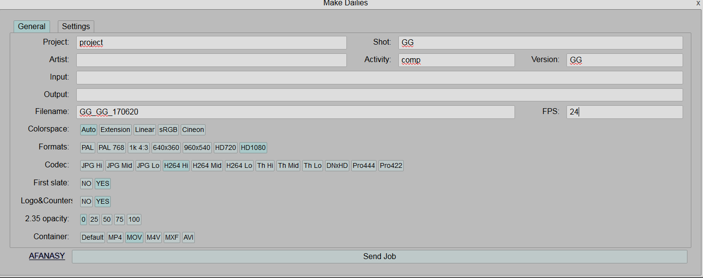

I make customization in "Make Dailies" Window on 2.1.0 in dailies.js. Attachements Included. But when I make all similar changes in 2.2.2 Nothing happens. "Make Dailies" window have old look. Any ideas?

- 2017-06-20 18_34_13-t-RULES.png (27.49 KiB) Viewed 35053 times

If you changing dailies.js changes should happen.
Sorry, for now i have no idea why it does not happen.
Just may be user has not refreshed page (F5) to reload script?
You can make any buttons you want.
cgru/utilities/moviemaker/makemovie.py is a very flexible script and has lots of parameters that are not preset in RULES dialog for it.
You even can to enhance makemovie.py, why not.
Also it you want to add such common options as cacher opacity, you can create a pull request on GitHub for it.
I think that all it will be useful for everybody.
And you will have no need to update it manually on each new CGRU version.
