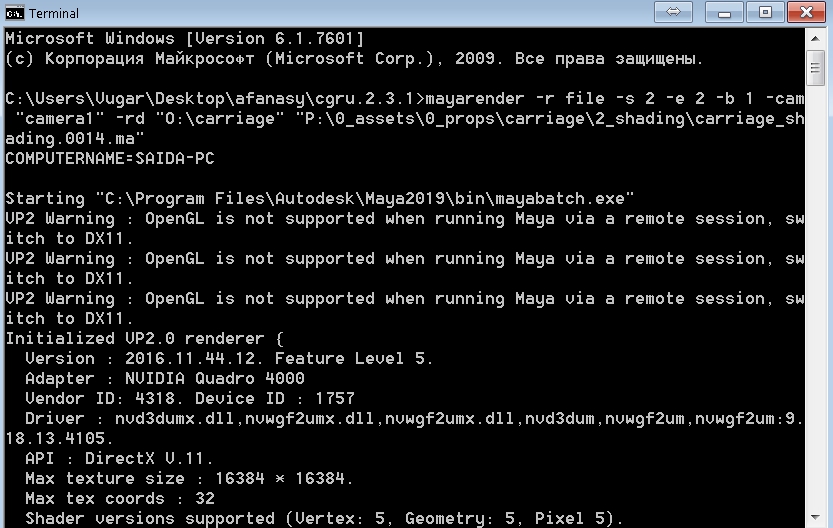

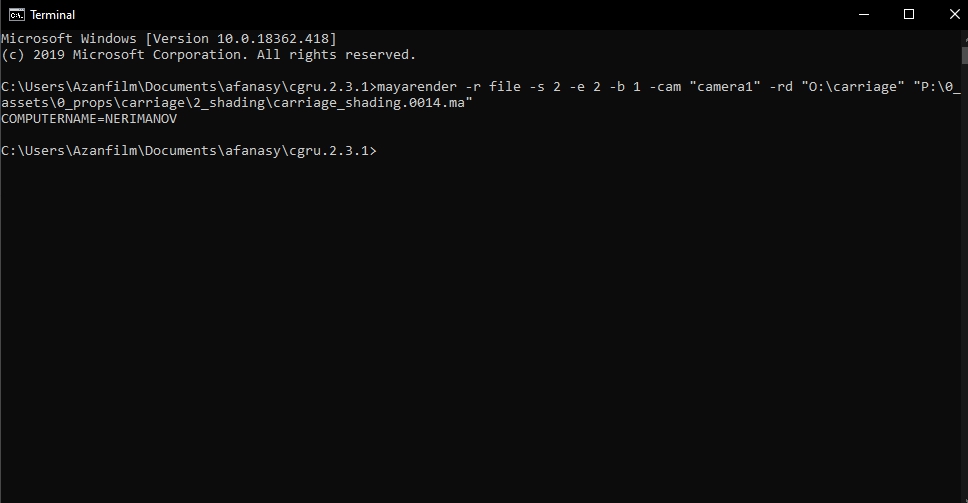

I went to afanasy terminal and ran the mayarender command and it just returns me the computer name.
In another computer render kicks in and completes successfully.
I see exit codes in terminal from render.cmd
The one that works

The one that doesnt work
Re: AVOIDING Exit Code -1073741819
So now you see your problem.
You should dig what is going on, what is the difference between computers.
May be mayarender script can't find Maya installation directory?

It seems like something is wrong with maya.
mayarender command is basicallu Render.exe called with arguments.
And Render.exe doesnt work either. Maybe i'll just wipe the OS :)
Ensure that it found Render.exe location.
