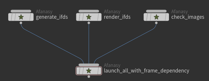

I connected three afanasy nodes like this
First generating ifds, second rendering mantras and third I wanted to run a script to check files after the render is done.
Everything works as expected, except after IFD's part is done, scan job takes over the mantra job. Doesn't wait for that one to be finished. Any ideas what I am doing wrong?

You should do something like this:

Great. Thanks a lot!
