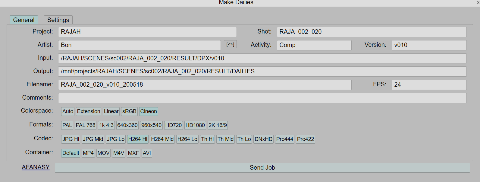

Hi Timur, thank you for your reply!
Yes, I can see at the task bar that it does resolve correctly to /mnt/projects/xxx/xx/xx/xx
I can also open vlc, djv_view etc directly from RULES without any problem. Walk works fine as well.
I'm not sure but I guess you want the command I can see in the log when I send off a daily yes?
If so, here is the output:
I have also attached a screenshot of how the daily GUI looks before I send.
Thanks,
Peter.
