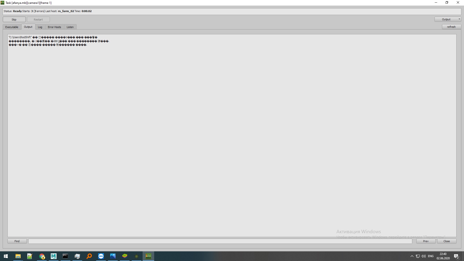

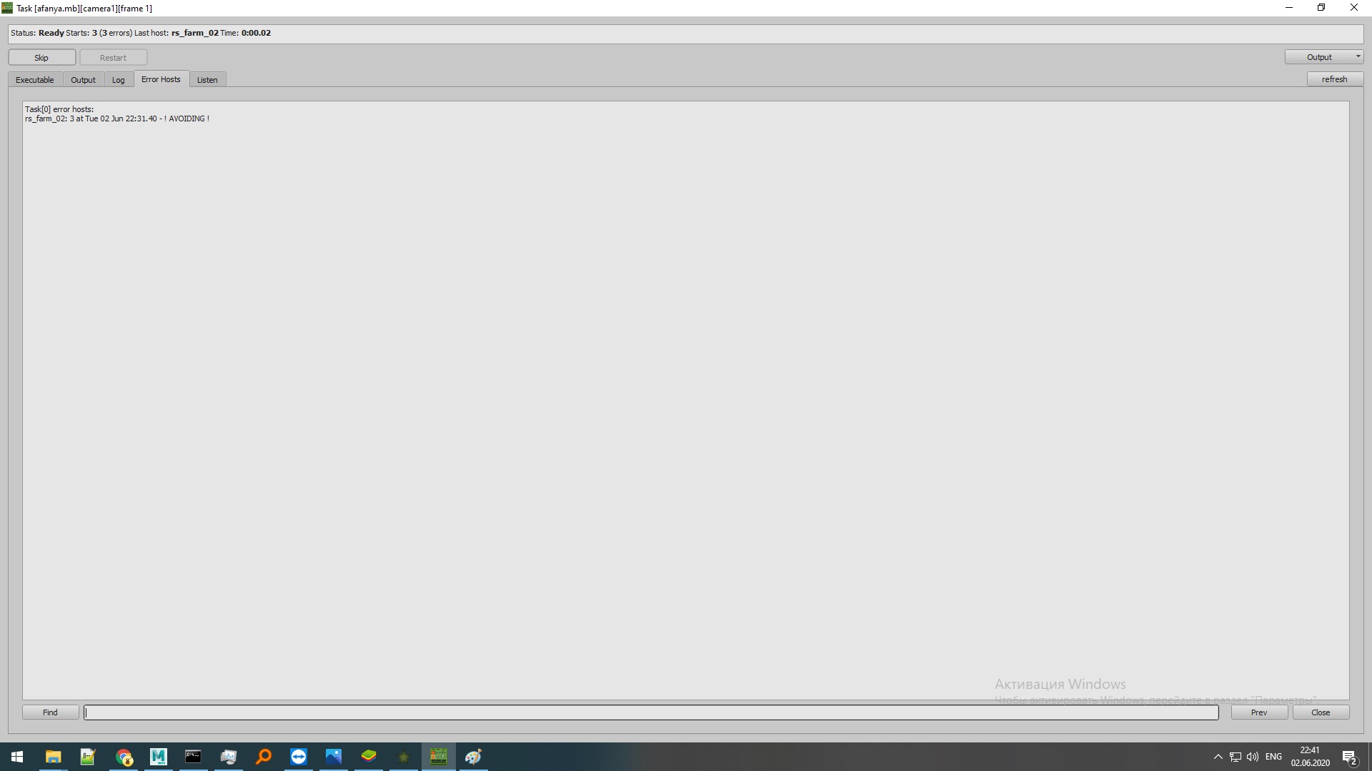

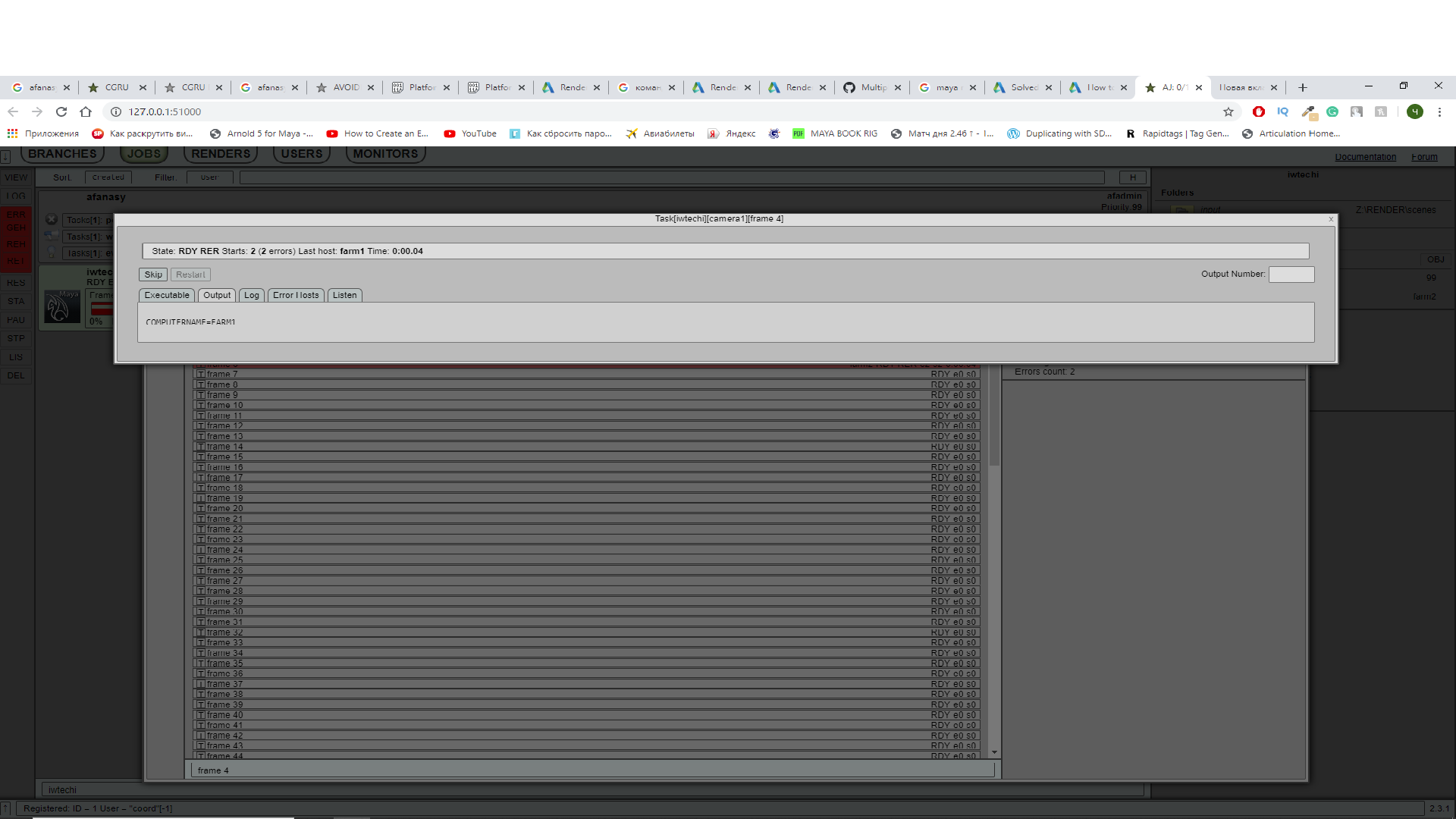

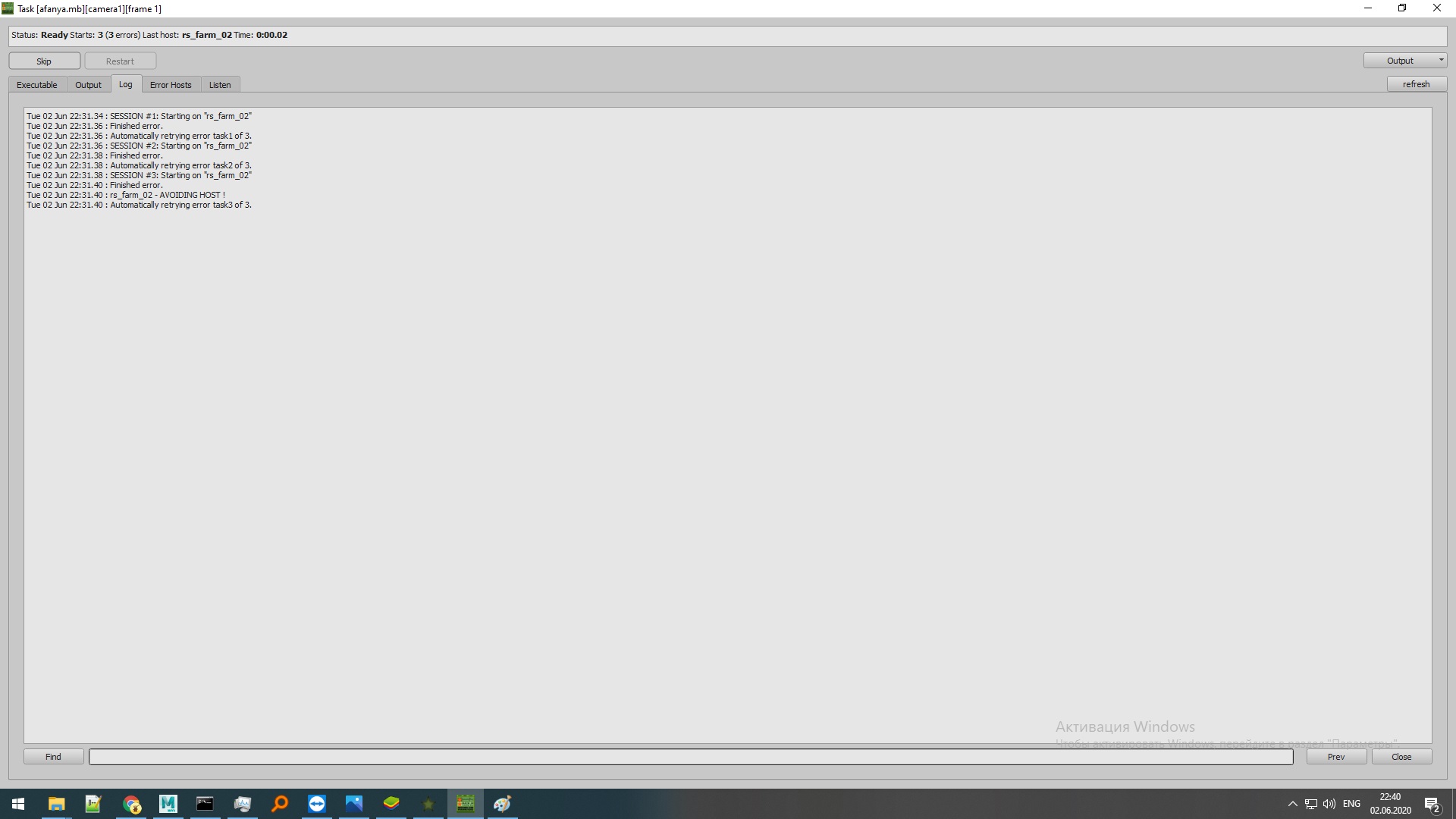

Hello there,
I have a problem, i cannot properly render my scene at all here are the screenshots
Error Host.jpg (120.66 KiB) Viewed 14050 times

Try to launch task command within console (cmd.exe).
You can open console (terminal) from cgru keeper, or call setup.cmd in the cgru root folder first.
ps
Try to use an english windows and ascii characters for work. MS Windows always produce coding errors.
