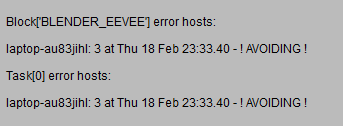

I'm getting this issue. Any idea how to submit the job without it saying avoiding host?
It says avoiding host
- Capture.PNG (4.46 KiB) Viewed 34290 times

When some host produced 3 error (this number is configurable) it pushed into avoid list, to stop to produce tasks with errors.
May be this host can't read fileserver or so.
This way other hosts can try to finish job with a success.
In a task log you just see that it was started, finished with a success or error.
To see task process error message you should see task output.

Re: It says avoiding host
I tried clicking on the job to see if there was a task or job output option on the web GUI but I'm unable to find anything showing task output. I'm only getting the show node log option on the left when I click on the job. Am I missing something? I'm on version 3.1.1.
Double click job - its tasks should open.
Double click task - task window should open.
There is all task info: log, output and so on.
