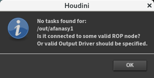

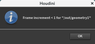

I would like to know how I can run substeps geo baking in parallel on the farm. It works on full frames, by setting the geometry ROP to 'Render Current Frame' and on my Afanasy to 'Render Frame Range'. This creates a task per frame that generates my geo file on disk in parallel. If I set the 'increment' to something lower than 1, I get following message boxes popping up:
And then:
