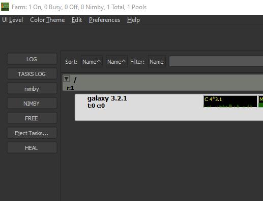

With AfWatch open I was looking through the manual where it says
You can add child pool to any parent pool using GUI. Root pool will be automatically created.
yet I was going quite mad because I could not find a way to add it from GUI (see image that shows no option)
Clipboard Image.jpg (17.51 KiB) Viewed 27399 times
Luckily someone informed me that the option is available on the web interface. Is this intentional or is my AfWatch not functioning correctly?
Re: Missing Options vs Web Interface?
AfWatch should be in admin mode to allow to perform farm modifications:
https://cgru.readthedocs.io/en/latest/a ... html#modes
