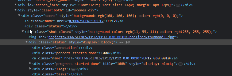

Did the switch today, but I got something strange happening with the thumbnails and other rules specific files generated, it goes into a folder called "undefined"
#80 21:19:40.345: GetFile cached[scene_bodies]: projects/BAXTER/SCENES/SC003/BK_SC003-0010/undefined/body.html
Any idea what that might be?

I think perhaps the "undefined" folder came from me doing a thumbnails process... because I can only see it in the project I did it in, not the others.
This is what the thumbnail source looks like when I view at SCENES level in rules:
