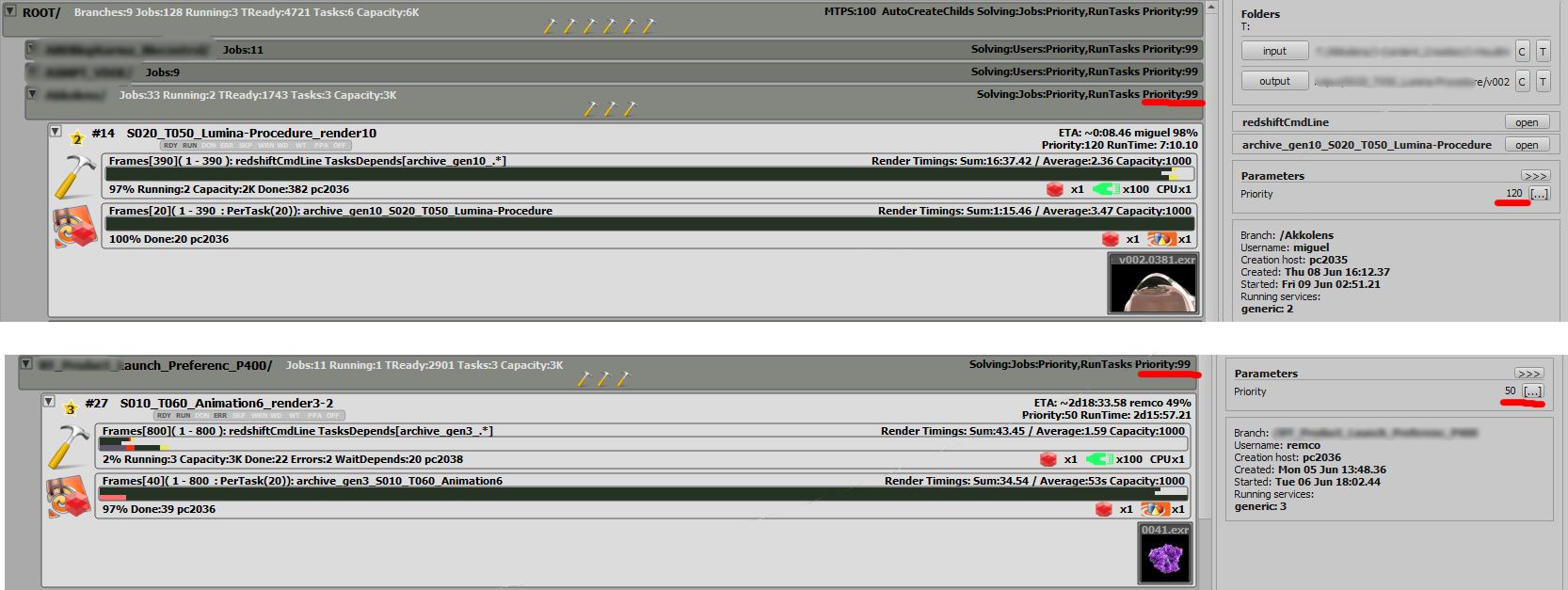

In the following image I have two jobs in different branches. The branch priority is the same, and one has a job priority of 120, and the other 50.
The job with priority 120 may get rendered first. It may not. I cannot find any consistency here. But also, if I were to swap the priorities, then eject all tasks from the hosts, the order should be reversed, but it isn't. It just carries on as before.
I tried again with only two jobs rendering. One at priority 200 and the other at priority 1. I then reversed the priorities and ejected all tasks, and again this has no effect on the execution order.
I have come to the conclusion that I do not understand how job priority works. I've tried many experiments and I've never been able to have any control over the order in which tasks are executed.

At first branches priority is solved. Then user priority is solved. At last jobs of same user in the same branch is solved and it plays just order role. So, job with a higher priority will be solved, and lower priority will just wait. So job priority plays just order role in the user jobs list. But you can change user "solve" from "order" to "priority", and priority will play a real priority role (not just order) but just for user jobs list.
So, if jobs are in different branches, job priority will not play any role.

Thank you for the reply, and no worries about the delay. We currently have branches based on the project name, and it's a nice way to organize things, but it seems I will have to put all work into the same branch for the job priority to have any effect (Solving was set to Job:Priority as you can see in the screenshot).
