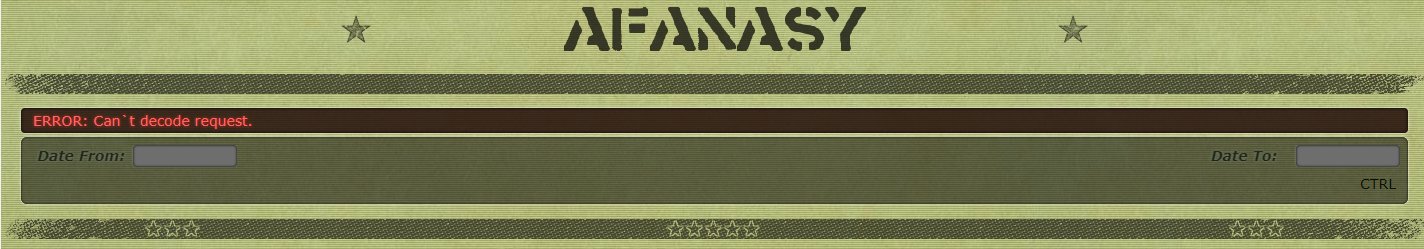

I have this error in apache log when I try load AF Statistics site:
PHP Notice:  Undefined variable: HTTP_RAW_POST_DATA in /opt/cgru/afanasy/statistics/server.php on line 7,
After searching this in google, I think it is because of php7 in ubuntu 16 vs php5 code in afanasy statistics?
AF statistics site
AF statistics site
Afanasy 2.2.3 . Server - Ubuntu 16.04.3 LTS. Clients - Windows 7 SP1
Re: AFANASY statistic server
Ah. Yes. I just fixed RULES for PHP7, but forgot about statistics, sorry.
Will be fixed in the next version.
