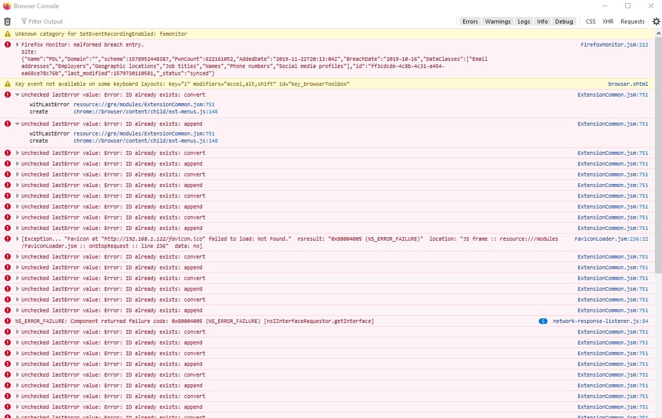

Hi
I do not understand what he wants from me
- Annotation 2020-02-05 151700.jpg (142.94 KiB) Viewed 67065 times
Re: Afanasy Statistics
Try to look at afserver logs. Is there any error inserting in DB tables?
Try to delete job(s). Only after job(s) deletion statistics is pushed.
To make web browser logs more readable, you should filter errors only and clear logs before F5 (to look at one session only).

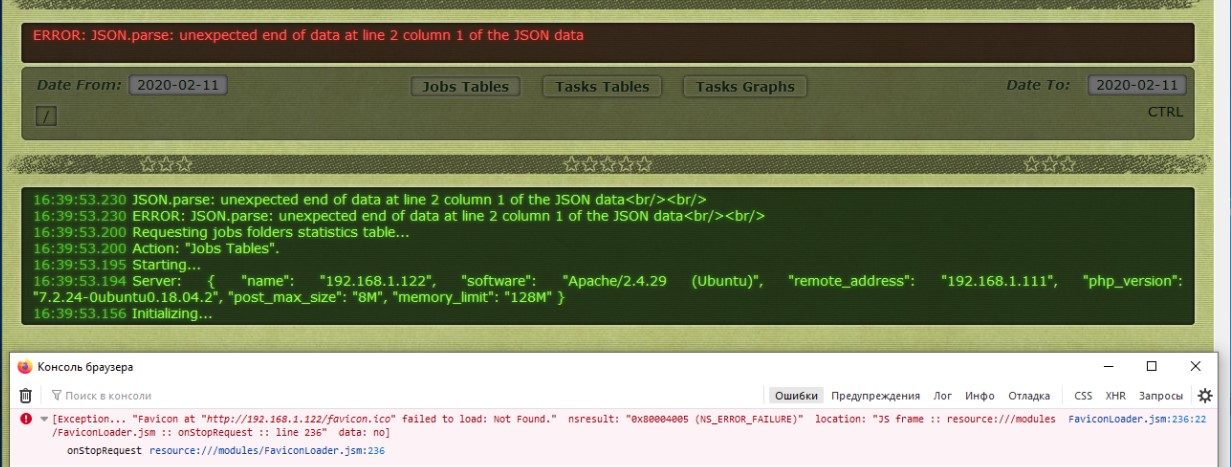

Hi
I corrected PSQL
There was no postgresql@10-main.service in the auto start
But now something does not like Afonasy
I corrected PSQL
- Annotation 2020-02-11 1638191.jpg (97.75 KiB) Viewed 67013 times
- Annotation 2020-02-11 163819.jpg (149.91 KiB) Viewed 67013 times

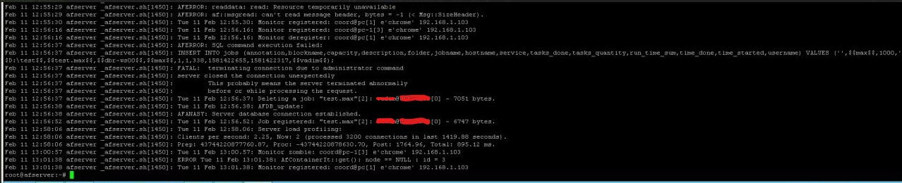

It turns out that the database is running, there is a connection with it, errors on the side of the log are not poured on it, but afserver cannot write data
May be afserver has not enough rights to write DB?
Try to google error that PostgreSQL module writes in afserver log.
And you can tell what is said in AfError?
You can see it in 100% scale. I see just a screenshot, that was scaled down. I am not a PostgreSQL guru, i can`t explain this error details.
AFERROR: readdata: read: Resource temporarily unavailable
AFERROR: af::msgread: can`t read message header, bytes = -1 (< MSG::SizeHeader).
AFERROR: SQL command execution failed:
INSERT INTO jobs (annotation,blockname,capacity,desctiption,folder,jobname,hostmask,service,tasks_done,tasks_quantity,run_time_sum,time_done,time_started,username) VALUES (' ' ,$$max$$,100, '$D:\test$$,$$test.max$$,$$MY_PC$$,$$max$$,1,1,338,1581422655,1581422317,$$USER_NAME$$);
ERROR AfContainerIT::get() : node == NULL : id - 3
I thought you was asking about PostgreSQL error: "FATAL: ...".
Afserver asked to launch that string to insert into table, but failed:
PostgreSQL library rejected and outputs some FATAL message.
This are Afanasy client -> server connection errors:
