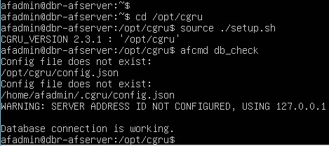

I have some problems collecting statistics from Athanasius
I did everything according to the instructions. Athanasius works
Database connected
Added PSQL and apache, in apache I registered the path to the cgru/afanasy/statistics/index.html

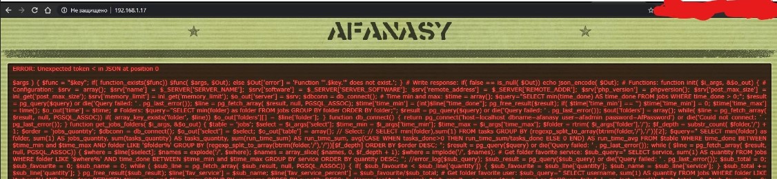

But when I open the link, I get lines of red code
What am I doing wrong?
OS Ubuntu 18.04
Afanasy 2.3.1
Afanasy, PSQL, Apache - one server

WARNING: SERVER ADDRESS ID - I changed the server address to ip, but this removed only the inscription about an unassigned ip

Have you installed libapache2-mod-php and php-pgsql?
(And restarted apache2?)

AAAAAAA
it was necessary to write just php, and I wrote from the instructions php5
Now I read that there is no php5, there is now php7
I did it, it worked, thanks a lot!

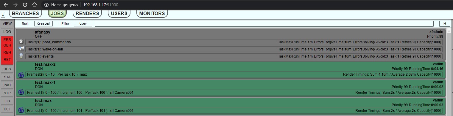

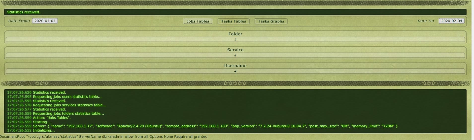

Hi
Today I launched three tasks, they were completed, but there is no information about them in the statistics
Tell me, what could I miss?

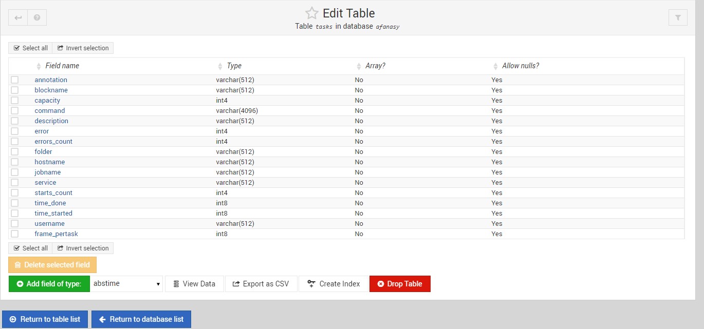

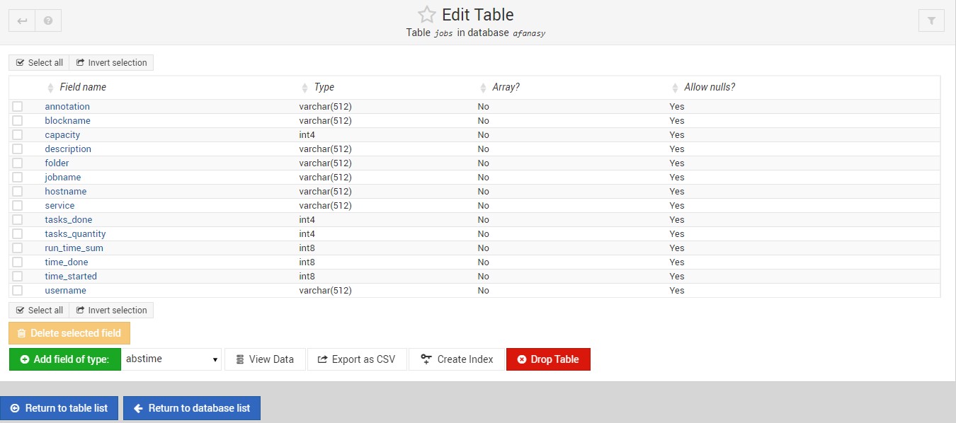

In the database itself, rows and columns are created

Re: Afanasy Statistics
Try to see server logs (afserver process output).
And firefox (web browser) console for errors.
