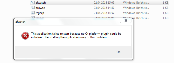

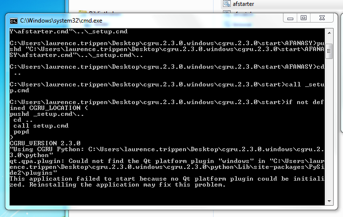

Re: Blender won't run from Keeper
No, the programs show the following error messages.
Images are in the attachments.
- afwatch.png (32.1 KiB) Viewed 17290 times
- afstarter.png (63.97 KiB) Viewed 17290 times
This is not a proper way to run Afanasy applications.
Keeper just walk this dir to construct menu. And run this files:
cgru/start/AFANASY
Anyway.
I just checked 2.3.0 release on a fresh Windows7 system and Keeper can't run anything.
May be something with the latest Python+Qt+PySide versions.
I just archived and put in downloads a version from my work, with not so modern Python+Qt+PySide versions.
And it works.
