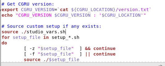

Post by giel_4321 »
Annotation 2020-08-11 190452.png (91.47 KiB) Viewed 15334 times
This is how it should be?
I just source /etc/profile in that studio_vars
Re: Cant find custom shell files
Do not modify native CGRU files!
It makes impossible to switch to the new version!
Here CGRU setup.sh sources any files matches setup_*.sh mask.
https://github.com/CGRU/cgru/blob/master/setup.sh#L25
So you should place any setup_abc.sh file and do anything you want with afrender environment.
