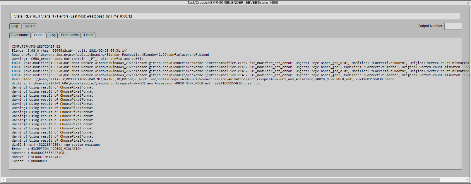

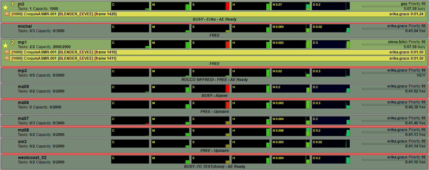

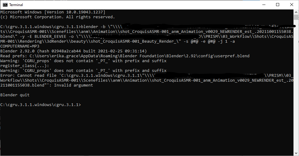

Here are some screenshots of the output and whatnot

"Avoiding":
If task process finished with an error, server starts it again, it "retries" error by default 3 times (configurable). After 3 errors, server mark task with "error". And will not try to run it any more (until user restats it manually).
If the same host produces 3 error (configurable too), it moves to "avoid" list, and this job (block, task) will not try to run tasks on this host. You can reset error hosts lists.
Task ouput:
Console task output says that Blender can open .blend file.
WebGUI task output says about some Blender specific errors. You can ask about this errors on some Blender forums.
