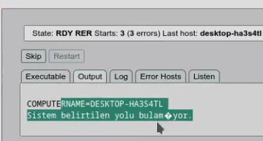

I couldn't solve this problem. CGRU root location gives an error due to a different address on windows.
Re: rendering with different operating systems
I see a warning in logs, that a task working directory does not exist.
What was a working directory on a machine where job was send?
What is you paths map?
It seems that you are using cgru root folder as a working directory.
May be you are not using it at all?
Or you should have a rules for it on paths map.

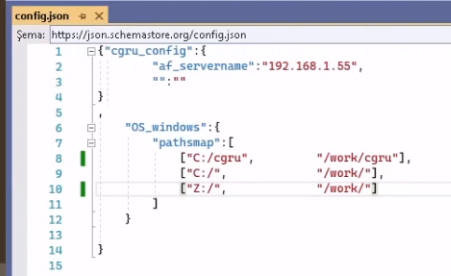

Let me show you like this. I use it for rendering through Blender.I have PCs with windows and linux operating systems.I am running cgru using the path in the image below.I am running on server.
Setting 2 or 3 configs sounded really confusing.

        "pathsmap":[
            ["Z:/",             "/work/"],
            ["C:/Users/Can/Documents/cgru",  "/work/cgru/"]

config in the cgru folder
{"cgru_config":{
"af_servername":"afanasy",
What I want to do is to be able to render with 2 operating systems in my local network. Good luck, it's a very successful application. But it got too complicated. Especially to be able to install on arch-based systems.I think I was able to make the necessary adjustments for rendering. But I could not set the cgru root folder. It felt really weird asking him to find this file.
https://cgru.readthedocs.io/en/latest/c ... nfig-files
It is a bad idea to modify config_default.json files directly. As native files can be changed in a new version. And you should apply your changes each time you update cgru.
To prevent this, you should create a new file cgru/config.json, where you just override only needed parameters, such as server address and paths map.If you have linux and windows, better to use linux paths as server paths, and windows as client.So each windows client should have pathsmap in config, linux clients should not have any.
Then you can say me, that i have such config.json on windows workstation, where i created a job: ...
On linux machine task have such command: ... (afwatch client on linux will show linux paths).
On windows machine task looks like: ...
Afrender on windows machine have such a warning in output: ...
Are there some warnings on linux?
And so on. But you even have not told what machine produced that output. I just can guess that it is a cmd.exe window by fonts looks like.
This is not valid json syntax:
You should delete 3-5 lines.
I do not understand this error:
May be it is not paths map theme at all.
It is very hard (needs more my time) to want movies.
Please do not send me movies, i have no time to watch it.
Do not edit config_default files.
Create your own cgru/config.json file.
On any client it should contain server address, on Windows it can contain server address and paths map (or you can have one shared config file for linux and windows with OS_windows or OS_unix sections).
You can just copy&paste it here to show me, without any screenshots or movies.
