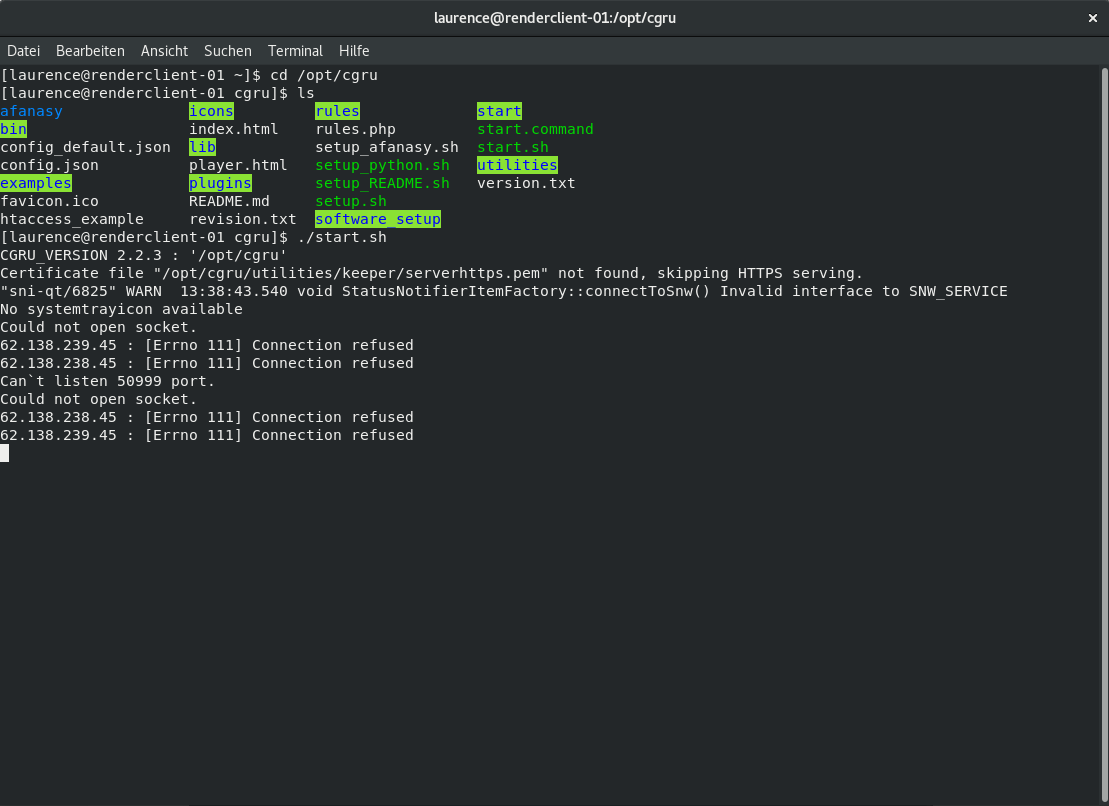

I have installed CGRU on my Fedora 27 Workstation.
I would start the Keeper but I became this error. (screen is in the attachments)
It's possible to run the keeper in the new GNOME 3.26 environment?
Thank you very much!

Re: Keeper System tray error (Fedora 27)
Thank you for your prompt reply.
My mistake. The attachment should be now there.
- nosystemtray_error.png (90.51 KiB) Viewed 13128 times
I can`t say anything before i try Fedora27 myself. But i do not have it by hand.
I just raise various virtual-box machines periodically to test releases on a modern distributions.
You case can cause new Gnome3 "system tray icons" approach and a new Python (PyQt/PySide) issue.
Try to install XFCE window manager - it is a render client, why it should have a modern windows themes?
Try to install change (uninstall / install) between PyQt5 - PyQt4 - PySide - PySide2, or what ever your distribution has, may be it will work somewhere.
I is very strange to have render-client on such distribution. Fedora is used to test something, not to work. If you want a stable and free RedHat based distribution - use CentOS, it is much more similar to RedHat (has the same sources) than Fedora.
Thank you very much for your help.
I will try it on CentOS 7.
